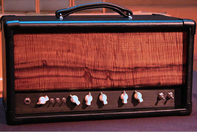

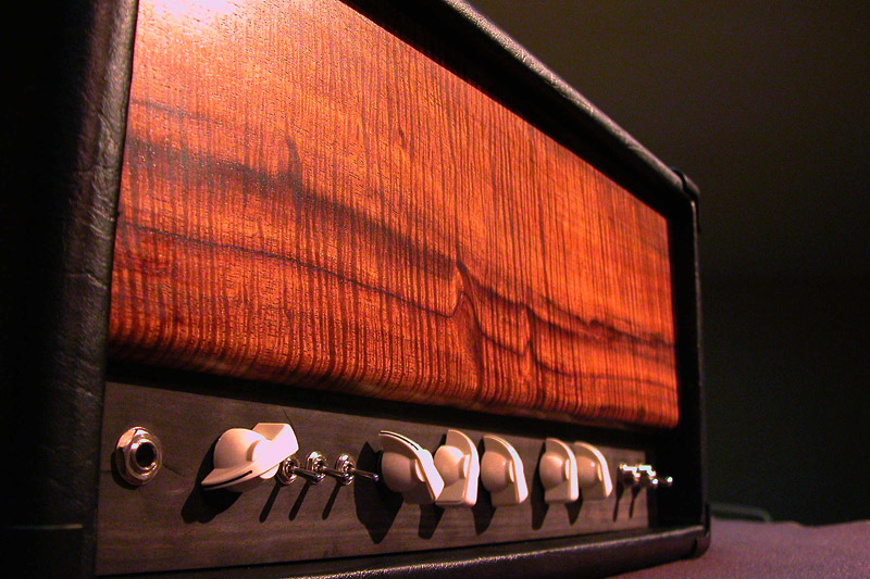

Well, after a good bit of juggling this week between a truck repair gone horribly wrong and this cabinet, I was able to finish this amp. It is a 35 watt Dumble inspired head. The baffle is koa from Volcano, and I used a fretboard blank for the ebony faceplate (this isn't something I would do again---the ebony is extremely fragile after being thinned to .040".
It has some cool features. The first toggle switch is a bright switch that adds life to humbuckers, the middle toggle switches to overdrive, and the third lifts the tone controls out of the circuit which turned out to be my preferred sound. My friend Dave and I plugged in a guitar at church after taking these pics and were able to nail this sound. Unfortunately, I was hoping for something else in the cleans. The cleans are rather mid-focused, and I wanted something warm and full to compliment the Voxy amp I did last year. I was hoping for a blackface Fender sound and amp surprised since the tone circuits are so similar.
It was really difficult to photograph because we didn't think of bringing a tripod. After a few shots, we gave up on style and just tried to get steady ones.

That's a beauty, James.  I haven't seen too many amps with nice woods on them. I think the only one was an Alessandro, Red Bone Special with a maple case and a birdseye maple face plate, that my son bought.  I know there are others out there.  This one, though, is great looking, but also functional with the Tolex box and just the nice Zoot on the face.
Good job.

Thanks guys. It actually looks so much better than the pics really show,
and I wish I had a camcorder so I could make some video clips. The
sound is SO defined. It's awesome.
